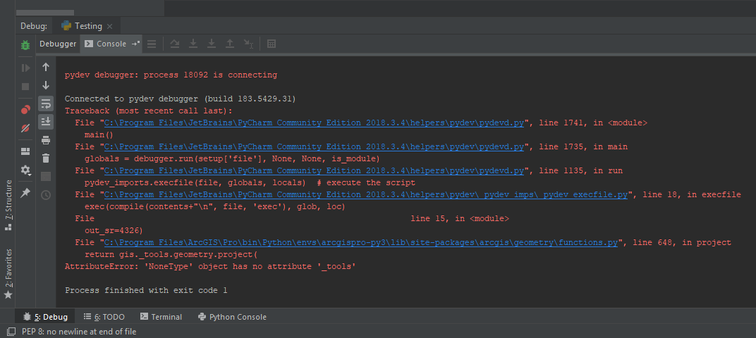

I get the following error message:
AttributeError: 'NoneType' object has no attribute '_tools'

You don't have an active GIS defined.  Add the following 2 lines before your code:
from arcgis.gis import GIS
gis = GIS()

MikieKelly
Thanks Joshua - that does the trick!
