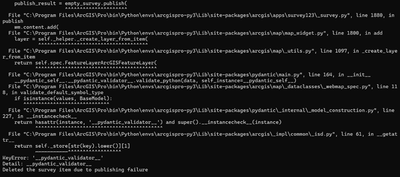

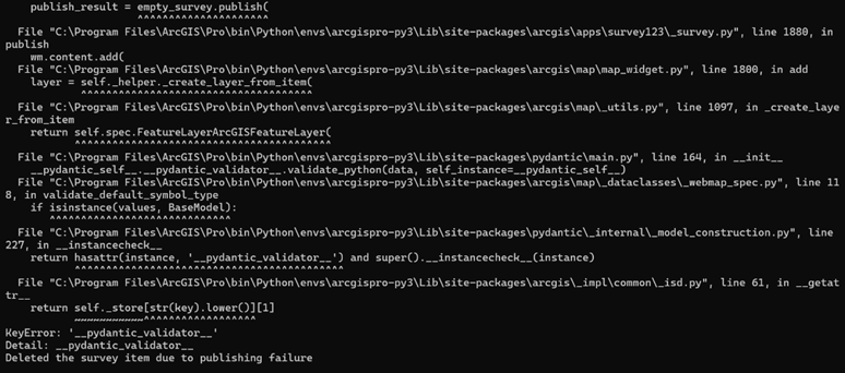

I’m trying to create a Survey123 form using the ArcGIS Python API(version 2.4) from a hosted feature service view from AGOL that has multiple layers.
The service view layers are A, B, C. My XLSForm schema corresponds to A, and form_id = A. It works when A is the first layer in the service, but fails if A is the second or third layer, showing:
I expect Survey123 to allow any layer in the service as the form’s target, not just the first.
Has anyone encountered this? Is there a workaround to use a non-first layer for form submission?

Hi @AbinayaAS,
Are you able to post your code so we can take a look?

AbinayaAS
Hi @Clubdebambos,
Yeah, Sure! I've uploaded the code for your reference.
