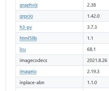

I've installed the 'ArcGIS_Pro_32_Deep_Learning_Libraries', the Manifest of included packages for pro 3.2 does not include the library 'huggingface_hub', does this mean the edge detection model cannot be used for pro3.2?

The manifest of packages is here
Esri/deep-learning-frameworks: Installation support for Deep Learning Frameworks for the ArcGIS Syst...
which defaults to listing the current versions.  For previous versions (like 3.2), look for the link and expand it
Manifest for Pro 3.2 / Server 11.2
links to the source packages can also be found there
... sort of retired...
SicenLiu

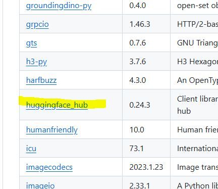

I cannot see ''huggingface_hub'' under Manifest for Pro 3.2 / Server 11.2, but running the edge detection model seems to require ''huggingface_hub'', does this mean the model cannot be used for Pro 3.2?
For advanced version like Pro 3.4, I can see ''huggingface_hub'' is included.

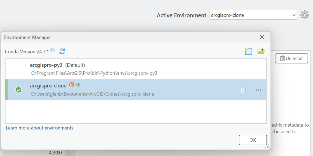

Clone the default environment in ArcGIS Pro, you can add libraries to a cloned version but not the default. Point ArcGIS Pro to use the cloned environment. I use pip all the time then to install various libraries from the command line with path\to\the\cloned\python.exe -m pip install library_name

PriyankaTuteja
Hi @SicenLiu ,
Thanks for following up!
You should follow the following steps:
1. Install ArcGIS Pro .
2. Configure deep learning environment using Deep Learning Installer.
This will install environment in the default arcgispro-py3.
3. Clone the default environment to install external packages required to run third-party models if required.
That said, the edge detection model was uploaded in 2024 and has been supported with Pro 3.5 and later.
