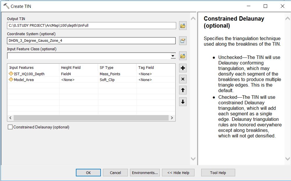

With both inputs in the ArcMap GUI it works with no problem (picture) and result is correct.

Have you tried going to the geoprocessing results in ArcMap and copying the results as a Python Snippet?  The snippet should give you a better idea on how you need to format your Input Feature Class parameter for the tool in Python.
I'm guessing based on the tool help it would need to be a list of lists, with comma separated values for each Input Feature.
[['IST_HQ100_Depth.shp'   , 'Field4' , "Mass_Points" , None],['Model_Area.shp', None, 'Soft_Clip' , None]]

It's true in the example they just use a single string with space seperated values.  I recommended differently for multiple inputs due to the help for that input showing the parameters as such:
in_features [[in_feature_class, height_field, SF_type, tag_value],...]
However, seeing as the input for the parameter is a Value Table, I believe you are right it needs to be a space delimited single string.  I'm finding the help for that parameter a little misleading and it probably should be updated to show multiple features better.

martinaraffellini
Deactivated User
this works!! thanks
