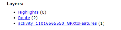

Source-Service layer ids:
View layer ids:

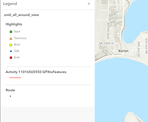

When the view is opened in the map viewer, the layers are messed up. The Route line layer has become a point layer and one of the point layers (the one with the very long name!) has become a line. A complete mess.
This happens consistently, on more than one platform. It does not happen when views are created manually. Also, create_view works fine when the layers are ordered sequentially 0 to N, top-down.

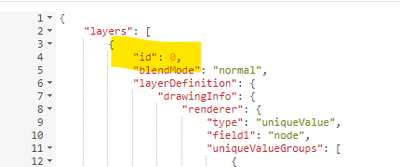

Meanwhile, the workaround is to manually zero-based index the layers in the hosted feature layer using https://ago-assistant.esri.com/
I'm working on a solution in Python but haven't gotten there yet.
