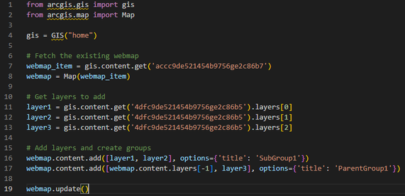

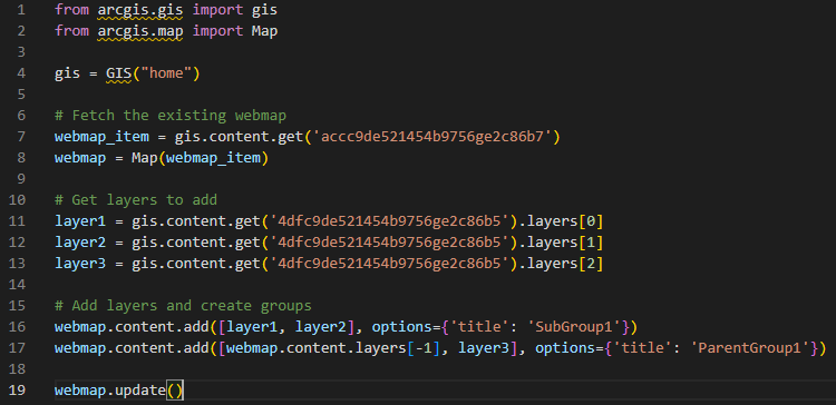

I am trying to create nested group layers using Python. I am able to create group layers and add them to a webmap on Enterprise Portal 11.2. I wrote the code several different ways and haven't been able to get nested group layers to work. The code below works for group layer, but when I add the line that would add the nested layer it doesn't work. I get an this error: AttributeError: 'GroupLayer' object has no attribute 'properties'.
This is the simplest version of the code. Any help is appreciated.

Hi @MaryHooper,
There is probably a couple of ways to do this. Through the Map object like you are attempting and my example follows suit, or you can manipulate the JSON from the WebMap definition in the WebMap item object instead.
Create the nesting before adding the groups. Take the below for example where I add layer3 and 4 as a SubGroup (nested list) when using add(). When using the title option it will name all groups (parent and children) the same, so you have to account for that and update the title of the subgroup(s) separately.
I have used Feature Layers from a Feature Service below, but you can also use map.content.layers[-1] or other index to grab a Feature Layer object from the map itself.
from arcgis.gis import GIS
from arcgis.map import Map
gis = GIS("home")
## Web Map item object
webmap_item = gis.content.get("WM_ITEM_ID")
## Map object
webmap = Map(webmap_item)
## FeatureLayer objects
layer1 = gis.content.get("FS_ITEM_ID").layers[0]
layer2 = gis.content.get("FS_ITEM_ID").layers[1]
layer3 = gis.content.get("FS_ITEM_ID").layers[2]
layer4 = gis.content.get("FS_ITEM_ID").layers[3]
## add to Map object
webmap.content.add(
    item = [[layer3, layer4], layer1, layer2], # added to map from bottom up
    options = {
        "title" : "Group Layer" #this will name the group and sub group the same
## update the sub group name
webmap.content.layers[0].layers[0].title = "Sub Group"
## update the Map object
webmap.update()
I hope that helps, but let me know if anything is not clear.

MaryHooper
Thank you, that worked. While I was waiting on this, I did manage to do it with the JSON. It's nice to know how to do it either way.
