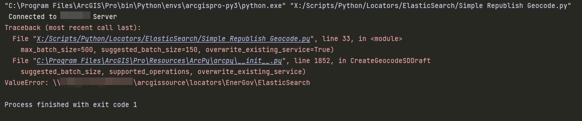

I have a script to overwrite an existing locator service, in a standalone ArcGIS Server (10.9.1) The code was originally shared by ArcGIS Geocoding Team here
I'm getting the following error when creating the sd draft file
I already checked and all my paths are correct. Any ideas?

Was the address locator created with the CreateAddress Locator (ArcMap) tool or Create Locator (Pro) tool?
Can you try having everything local (instead of network share) as a test to see if the script runs?
AliciaShyu
The locator was created using the Create Locator (Pro) tool.
Changing everything to my local machine gives me the same value error showing the local path.

Is the script in this link the same as yours?
https://community.esri.com/t5/arcgis-enterprise-portal-questions/overwriting-locator-python-but-it-c...
If so, how do the input parameters look compared to yours?
AliciaShyu
Yes, the only difference is that I don't have portal setup, so I'm connecting to the server to upload the service.

A couple of ideas...
  • In past versions of arcpy the .LOC was not required maybe try to add the .loc to the full locator path and see if this resolves the value error
  • For the ArcGIS Server connection, try removing the .AGS from the connection file used for the publication. This change occurred somewhere around Pro 2.7.
  • Was the ArcGIS Server connection file created in ArcMap or ArcGIS Pro? There is a difference mainly with how the credential is saved and believe we had to convert our connections over to the pro versions.
AliciaShyu
At 10.9.1 (ArcGIS Server) you don't need to republish the locator service. The script only needs to stop the service, rebuild the locator and start the service.
RonnieRichards
Thanks for this info @AliciaShyu I am curious though, what is the source of your locators?
In our situation, they are file based locators and published to servers so not sure how a script stopping/starting the service would even have access to the published locator unless the server resource directory is shared.
