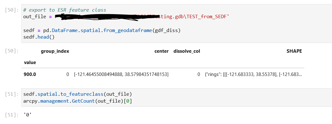

Greetings All,
I'm trying to do the following:
  1. Convert JSON results from OpenRouteService API into geodataframe
  2. Convert a geopandas geodataframe to a Spatially enabled dataframe (SEDF) using .from_geodataframe()
  3. Export the SEDF to a feature class using .to_featureclass()
As the screenshot below shows, the conversion from geopandas GDF to ESRI SEDF is successful, but when I try exporting the SEDF to a feature class, the resulting feature class has no features in it.

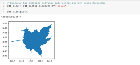

Yes, it plots correctly when I plot the geopandas geodataframe:

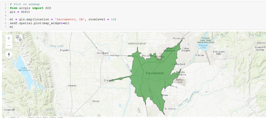

It also plots correctly after I convert the GDF to ESRI's SEDF:
And as I mentioned in my original post, if I do SEDF > FeatureSet > GeoJSON File > Feature class, it works. So the kink is when trying to directly go from SEDF to feature class.
