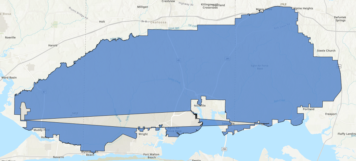

I use a script to get data into our ArcGIS online organization, but it seems like the GeoAccessor function messes with the vertices and outputs wrong geometry.

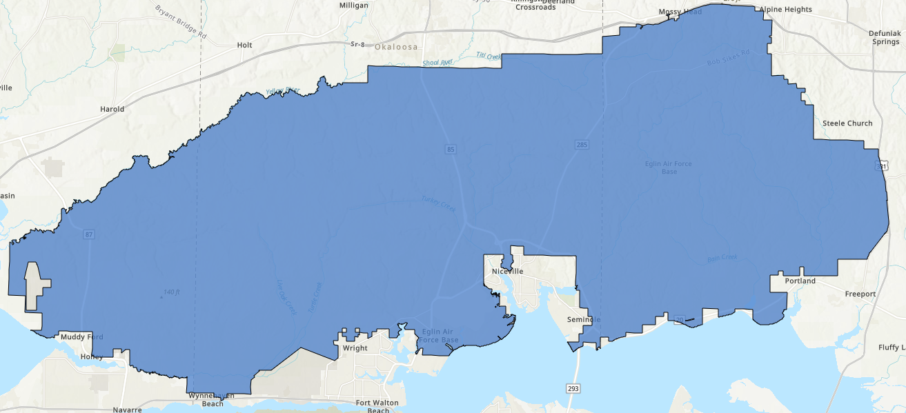

Source Data:
Polygon after adding to ArcGIS online using the script below:
Not sure how visible it is on the screenshots here, but it seems like the 2 inner holes of this big polygon get all mesed up when converting the geodataframe to a sedf.

I have fiddled with this for hours. I tried the .buffer(0) method - didn't work. I tried the make_valid() function from shapely.validation too. Filling holes before converting to a spatially enabled dataframe worked, but it is not an acceptable solution.
Any ideas? I have thought the vertices ordering might be to blame, since ESRI uses different clockwise/counterclockwise direction for exterior/interior rings, but I don't know how I would go about to change those.
