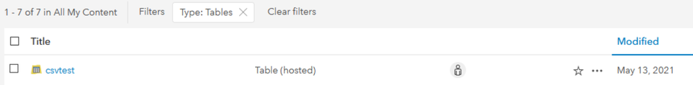

There is, however, a table in my content. I can find it with the required query parameter alone. The item type will come back as Table Layer, which, as you see above, I have tried.
table = gis.content.search(query="title:csvtest")
###result
<Item title:"csvtest" type:Table Layer owner:admin>
