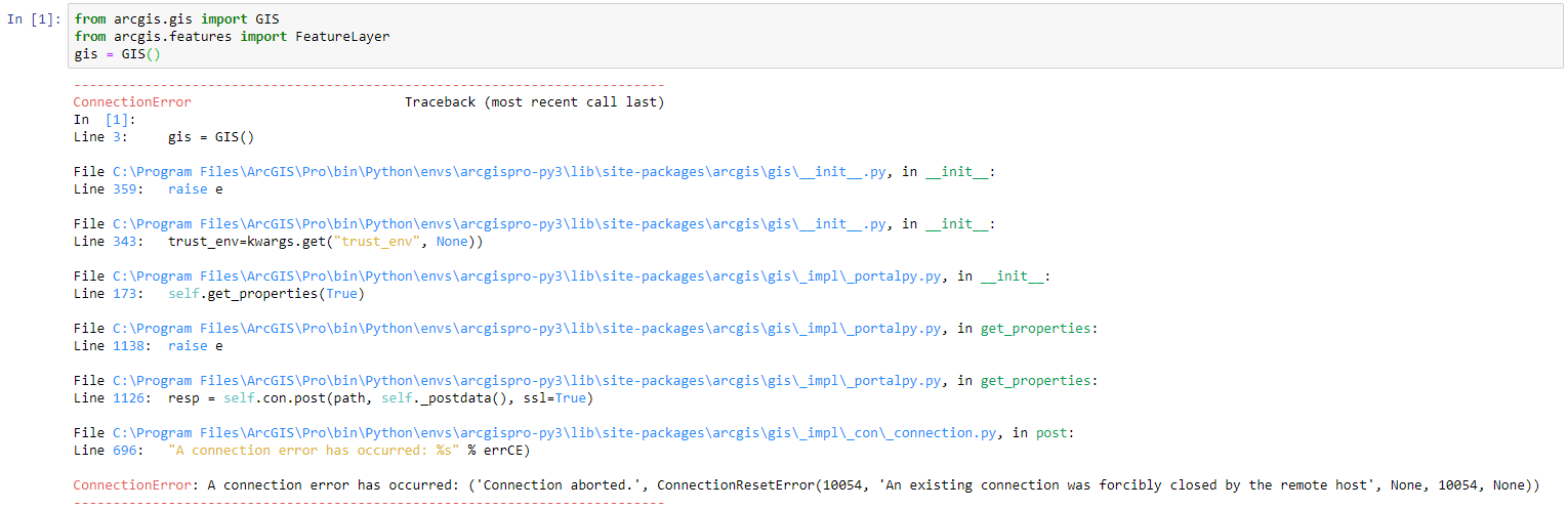

Hi all. I'm very new to ArcGIS Pro and the ArcGIS API for Python. It says in the documentation that if I install ArcGIS Pro, I don't need any other installations, however, I've been having this connection issue at the very first step:
from arcgis.gis import GIS
from arcgis.features import FeatureLayer
gis = GIS()
Anyone knows what's happening here and if I need additional installations/environments?
Installed: ArcGIS Pro 2.8, Python 3.7.10, ArcGIS API 1.8.5
neil_perol
I found the underlying issue with this, and it's because of the network firewall. I am working on a government building and we have a very secure network which closes the connection as soon as it's made. I tried the codes at home and they work just fine.

Hi Brian, thanks for the reply.
Theoretically, I should still be have an anonymous connection to www.arcgis.com if I use gis = GIS().
I also tried adding portal url before posting this question, but I still couldn't connect. A different error though:

neil_perol
Thanks for your replies, Brian. They were very informative. However, I found out that the issue is with the network firewall which is very strict. I tried the codes at home and they work just fine. 🙂
