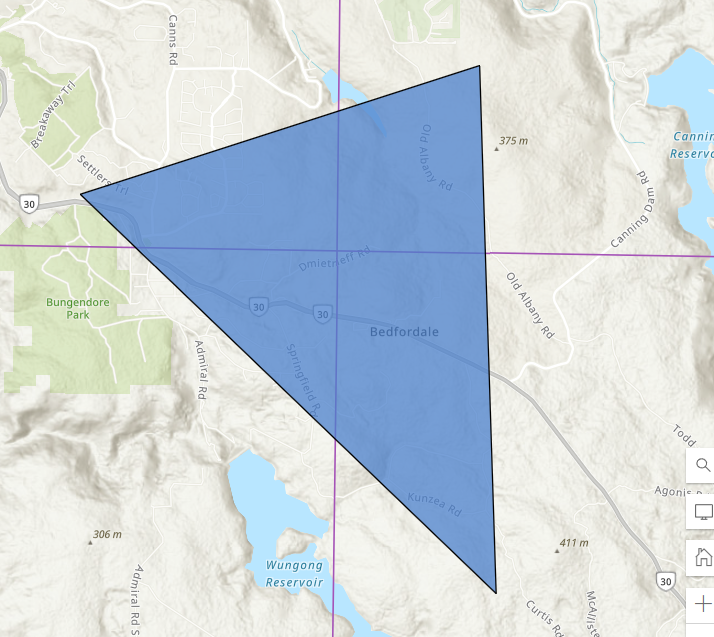

Hi, I am trying to find the length of polyline in a polygon however clip only accepts envelop (rectangle). what can I do to get the total length of the polyline within a polygon. Thanks in advance.
for track_f in track_fset.features:
        track_polyline = Polyline(track_f.geometry)
        clipped_track_polyline = track_polyline.clip(Polygon(bounding_geom))
        print(type(clipped_track_polyline))

DavidPike
MVP Notable Contributor
try intersect()
vtey_esriau
wow, thanks @DavidPike . I simply assumed intersect returns True or False :D. I tested with intersect and it is returning a multipoint. Any advise on how to convert that to a polyline?

vtey_esriau
thank you 🙂 that worked. I should really learn to read the documentation.
I was reading - https://developers.arcgis.com/python/api-reference/arcgis.geometry.html#intersect
