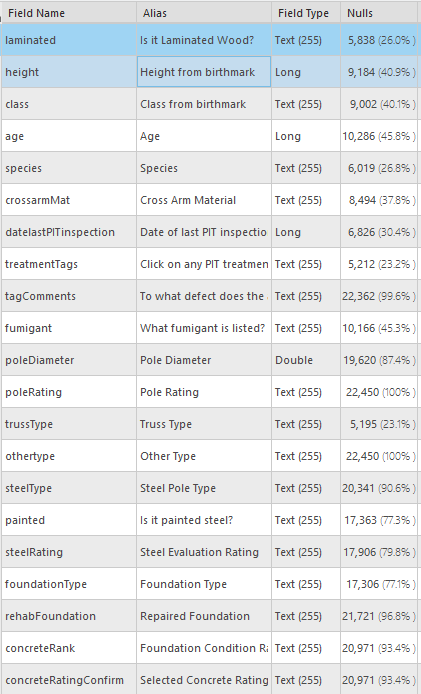

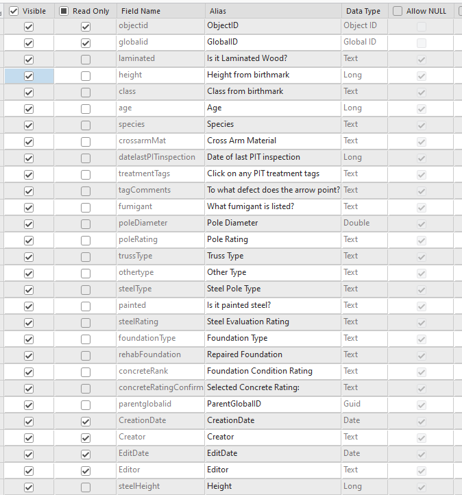

And here is the analysis of my fields:
I do have some fields that are type Long, but they also do allow nulls.
