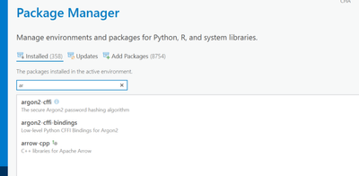

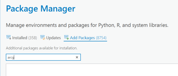

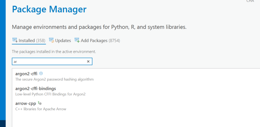

Hi guys, hope you all are doing well.

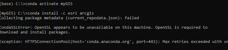

I could not find arcgis from my ArcGIS pro package manager, so I tried to install arcgis in conda with the Prompt, but always failed, pip failed as well.
The error message is "CondaSSLError: OpenSSL appears to be unavailable on this machine. OpenSSL is required to download and install packages." But I have downloaded and installed the latest OpenSSL already. Please let me if you have any ideas, I sincerely appreciate your help.
