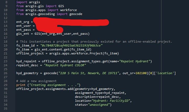

I am new to Python script writing, but I am trying to learn!
I wish to write a script that will create a Workforce assignment depending on the results from a fire hydrant inspection.  Both the inspection feature service and the Workforce service are hosted on our Enterprise Portal, version 10.9.1.  I tried to follow the section on this page Managing Workforce projects | ArcGIS API for Python that talks about creating a new assignment but I keep coming up with errors that I can't figure out how to fix.  I only really need three attributes to pass over to the assignments creation (geometry, assignment_type, and description) and looking at the page arcgis.apps.workforce.managers module | ArcGIS API for Python section for adding assignments it looked to me that all the attributes are optional, but I kept getting errors that there needs to be a location and the status can't be none so I added them as well.
Here's the code I've been trying:

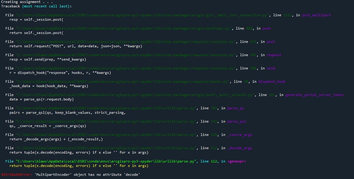

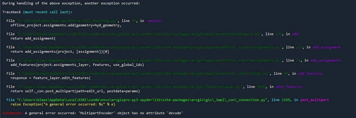

And here's the output I'm getting:
I've done all the googling I can for now so I'm hoping to get some help here in either how to fix this code, or find a better way to script creating a new assignment.  Any help would be appreciated!
Brian

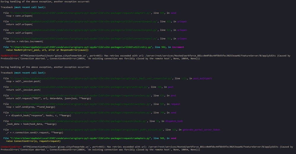

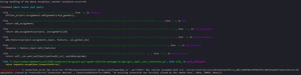

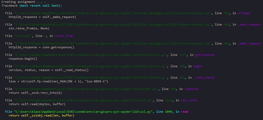

So after a month of plugging away at this code . . . we've discovered that some of our other scripts that were previously working when we wrote them were now throwing some of the same errors as I was getting with this code.  (This seemed to happen after we upgraded to ArcGIS Pro 3.0)  After some trial and error with the previously working scripts we found that if we just connected with our Enterprise/Portal without specifying a username or password then the script would run as it did before.  I then tried the same thing with this script and it looked like it was going to work, but then after about 7 minutes I get the following errors:
It looks like it's connecting to the Workforce project, but can't write the new assignment and times out after some period of time.
