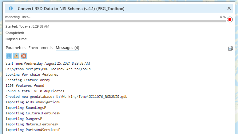

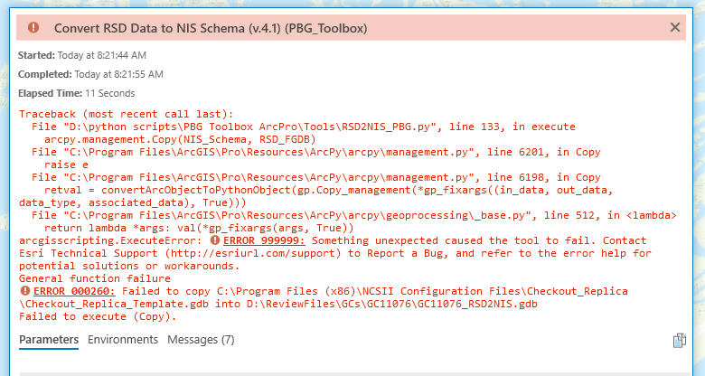

And here are the results (K is network drive; D is USB drive):
Network drive worksNetwork drive worksUSB drive failsUSB drive fails
When it fails, there is a copy of the original database in the D drive folder that has not been renamed.  And the template seems to have everything it should- it just hasn't been renamed and that's where it failed.  I've tried a lot of different folders and any folder on the D drive files while it works fine elsewhere.  Any ideas?
