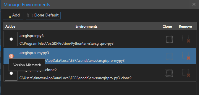

After upgrading my ArcGIS Pro to 2.3, the python environment I previously cloned and then modified stopped working because of the "version mismatch":

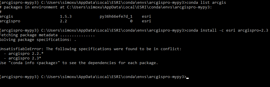

When I list the arcgis related packages I find the arcgispro package version is still 2.2, but the latest version should the be 2.3, and I believe that's why ArcGIS Pro reported "verion mismatch".
So I tried to install arcgispro 2.3 in my environment, but this seems not allowed, because there were conflicts.Please see below:
Since I have installed many other third-party packages, I don't want to give up my current environment until I run out of options.
I have cloned the default env of the new ArcGIS Pro 2.3, and successfully upgraded the ArcGIS Python API to 1.5.3, this re-assures that ArcGIS Python API 1.5.3 is compatible, it's the arcgispro 2.2 python package which is causing the problem.

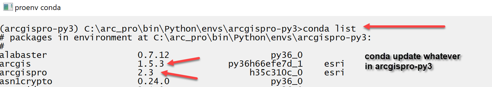

I just did a "dry-run" on updating ArcGIS 1.5.2 to 1.5.3 and this is the package plan.
I don't use the clone though, I just make updates to the  "envs\arcgispro" environment.

I upgraded to ArcGIS Pro 2.3.0.
and surprisingly, the ArcGIS Python API in my Pro 2.3 is 1.5.1 not 1.5.2.
The reason I cloned the environment to upgrade is the default environment doesn't allow modification. Please see the snipped screenshot below
DanPatterson_Retired
MVP Emeritus
The default environment is 'pinned' and can't be updated.
You can either clone, and change your working environment into the clone... or.
do what I do, use conda to update the default, but I am administrator on my computer.
So if you aren't the master of your environment, mess with the clone, or
I think the clone is to stop people calling when they foul up the default environment. By having a clone, the original is still there.
