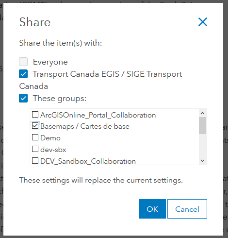

I have a web map that I wish to share with a group in ArcGIS Enterprise. Using the Portal, I can share the map with the group:
However, if I try to share the same map with the same group using the Python API, the map cannot be shared with the group:

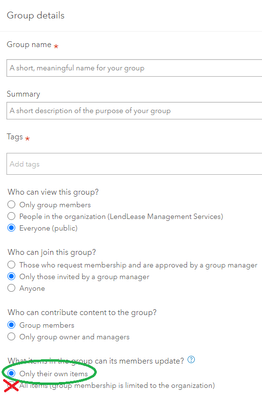

The errors above can also occur because items cannot be shared with group having users_update_items=True.
This is defined when the group is created and cannot be changed later:
JustinReynolds
This was the case for me.  You can share to a group with Update Capabilities, but you need to pass an additional argument to the share method (allow_members_to_edit=True).
