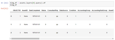

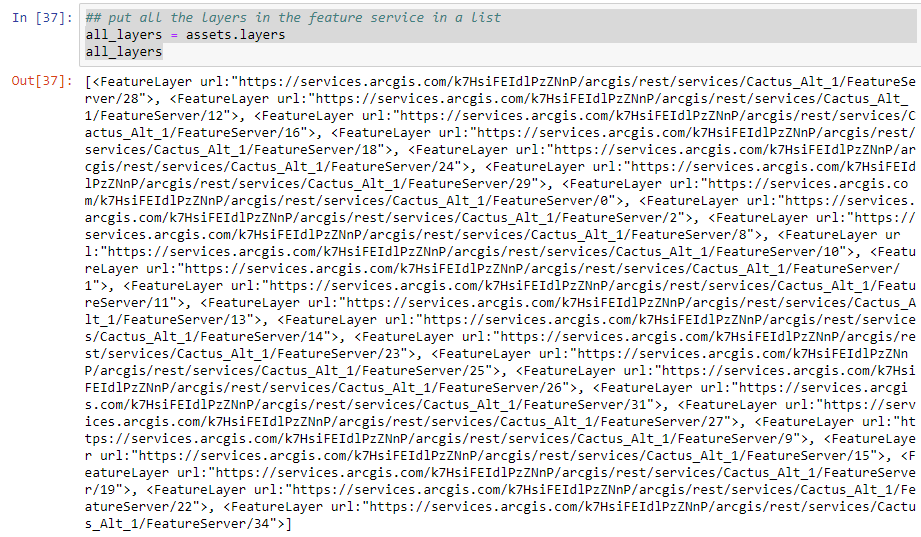

I can access the AGOL item and its layers:

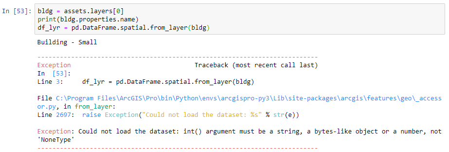

But when I try to read one of them into a spatially enabled data frame, I get this:
The layer contains 3 features, it's not empty.
Does anyone know why this happens?

I see this now and then. It's not about the layer itself, it's that a null value is being encountered when it expects an integer, and it's throwing an error.
Take a look at the data table, see if there are any fields where this might be happening.

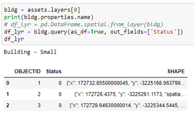

If you want to work around this, try instead using bldg.query(as_df=True, out_fields=['subset', 'of', 'fields']) to just pull what you need and potentially avoid the offending field.

Thanks for the reply. I can now confirm that fields that have no value cause this error. When I use the query you suggested and only include fields that are mandatory and therefore do have values, the code works.
