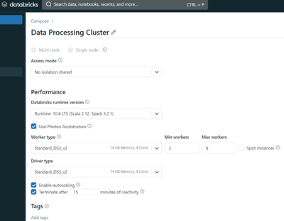

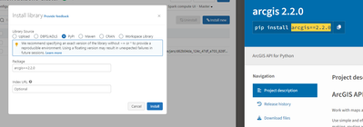

Is this still the preferred approach for getting ArcGIS API for Python into Databricks?  I have Geoanalytics Engine all setup in a Databricks Workspace on Azure, but just looking for steps on how to incorporate the ArcGIS API for Python as well.
I assumed I would be able to install at the cluster level so all notebooks would be able to import it when required:

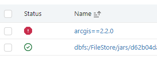

arcgis==2.2.0
However this fails

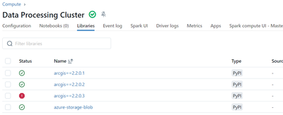

Hi Simon, I also have issues on using arcgis library on Databricks cluster. Even the library seem to be correctly installed, fails importing arcgis.
Does anyone has similar issues?

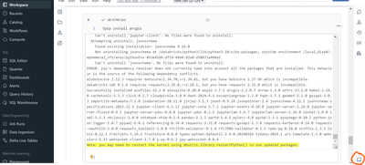

@SimonGIS @Roxana_ElenaUrdea I was able to get the arcgis library installed on Databricks by running the command sudo apt-get install libkrb5-dev in a terminal. You can open a terminal window by clicking the little icon in the bottom right of a Databricks Notebook page (see attached image). After that, I was able to run %pip install arcgis in a notebook cell, and it installed okay (albeit with some non-critical warnings). Hope that helps!
