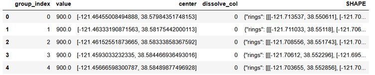

If it helps, here are the first few rows of the SEDF:
