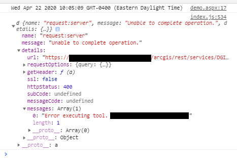

This is the error I am getting.....funny though when I run it from the GP Tool in ArcCatalog it runs fine

I went in and removed the Relationship Class from the Database
Republished the Service and the GP Tool Service
Reran my code from JavaScript to send the GP Tool a parameter and everything worked perfect...
So it seems that the Relationship Class is causing the error....Not sure where or what I have to modify to get this to work with a Relationship class....
