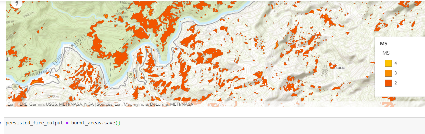

I'm trying to use the sample -  California wildfires 2017 - Thomas Fire analysis on my AOI and  I'm able to extract the burnt areas as shown below:
But when trying to save it, I'm getting below error:

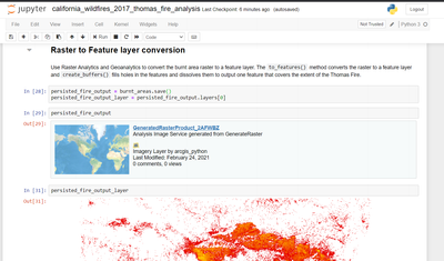

I have tried running this notebook using the above credentials and the cell
persisted_fire_output = burnt_areas.save()
worked for me. See the screenshot below:
I wonder what's wrong with your portal. Could you try using your credentials with verify_cert=False and see if it works.
