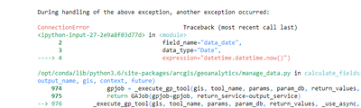

AFackler_NAPSG
Do I have to import a datetime tool to use that? I can do anything I want with the layer and the connection is coming from the expression (I think. I'm new to this stuff)
