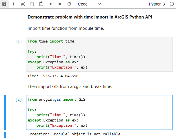

Hi, it seems importing the GIS breaks a former from time import time import as demonstrated in the following example.
          Code sample
Switching the imports works, but it's not intuitive, and neither very PEP 8.
It seems time.sleep() is the only function from the time module that are used in the API, and it is only used twice, in Item.export() and Item._check_publish_status().
Still, there are three instances of import time scattered around in the __init__.py file. Wouldn't it be better to narrow the import to a from time import sleep in the imports at top of the file?

I am unable to reproduce it with v1.5. What version of the Python API are you using?
HåkonDreyer
Strange, I'm on 1.5.
HåkonDreyer
But then, when testing in an environment not cloned from Pro it works…
JoshuaBixby
MVP Esteemed Contributor
I think this is more of an ArcPy issue than an ArcGIS API for Python issue, but it becomes an issue for the latter when the former is imported.  If you import ArcPy first (not suggesting it as a workflow/workaround, just for testing), then importing from arcgis.gis doesn't clobber your time import.

Unfortunately, importing from datetime and time can be tricky since the modules contain classes with the exact same names.  For that reason, I just import the time module since time() doesn't save much over time.time().  For datetime, I usually do from datetime import datetime as dt.
It would be great if we had a time.Time class instead of a time.time class, and a datetime.Datetime class instead of a datetime.datetime, but I don't know the full history of why those two modules ended up the way they did.
HåkonDreyer
Good point, guess it explains the difference between cloned Pro-environments and environments built in Conda.
And yes, switching the imports works, but it is neither intuitive nor good style as mentioned in the original post.
