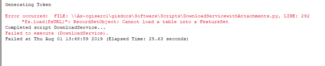

I ran into this error using your tool. I can't find any info on it on. Do you have any idea whats going on ?
LINE: 292
"fs.load(fsURL)": RecordSetObject: Cannot load a table into a FeatureSet.
JakeSkinner
Esri Esteemed Contributor
Adam Arcichowski‌ if you share the service to a Group and then invite my AGOL account (jskinner_CountySandbox) I can take a look to see what's going on.

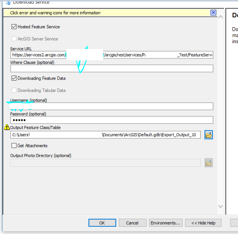

Hey Jake I've been using your tool for lots of data out there.
However I can across this error now. Do you know why? Do some datasets not allow you to download their data?
Specifally this data https://gis.bisclient.com/maps03/rest/services/RedRiverWeb/MapServer/0
