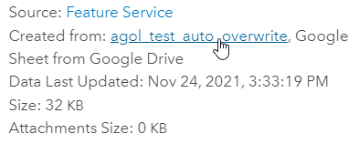

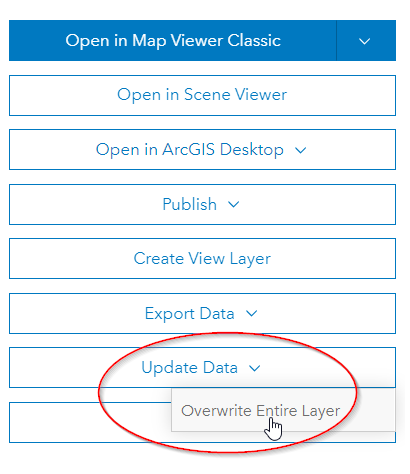

Hello, I have a google sheet with latitude/longitude columns that I added to ArcGIS Online via New Item > Google Drive > Google Sheets. I would like to have this update automatically, but it seems the only way to update it (sync it with the Google Sheets source) is through ArcGIS Online, clicking Update Data > Overwrite Entire Layer. How can I emulate that "Overwrite Entire Layer" functionality with python?
I've looked through the API documentation and various forum posts, especially the top reply in this post sounds very confident that there's a way to do it "quite easily!", but I can't seem to crack it. I've tried:
item = gis.content.get(item_id)
item.update(data=google_sheets_url) # returns True, but does nothing
where 'google_sheets_url' is the destination URL of the link on the AGOL item page:
I've also tried the FeatureLayerCollection.manager.overwrite() method, but I doubt that's the way to do it.

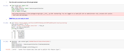

I have tried reading csv using panda and am getting this issue.

Maybe you could write the pandas df to a temp csv file on disk, then use the file path as the argument for FeatureLayerCollection.manager.overwrite() and delete the temp file. Then it would mirror this example: https://developers.arcgis.com/python/sample-notebooks/overwriting-feature-layers/
Could look like:
import tempfile
import os
g_csv = pd.read_csv(dwn_url)
with tempfile.TemporaryDirectory() as csvdir:
local_csv = os.path.join(csvdir, 'pandas.csv')
g_csv.to_csv(local_csv)
layer_collection.manager.overwrite(local_csv)
os.remove(local_csv)
