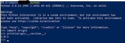

  • setting the 'path' system variable to the current cloned environment location and then typing 'python' in PowerShell yields the following warning: ZacharyHart_0-1664217924116.png
    but lists the correct version of the arcgis module. The same AttributeError is returned in this configuration.
  • The same Attribute Error is returned if the path system variable is set to the default Python environment as well.
