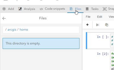

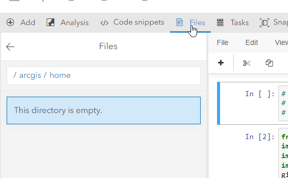

In the end, I've got the Boolean to be "True" as in, it worked.  However, when I go to my Notebook Files, nothing is there at "/arcgis/home".
Here's what I have so far (working in Jupyter Notebooks):

So, it's saying True, as in it worked, but when I check, nothing is there.  See below.  Any help!?  Be nice, I'm a intermediate/beginner! 🙂  We've been working on this for days, this is the closest we've gotten.

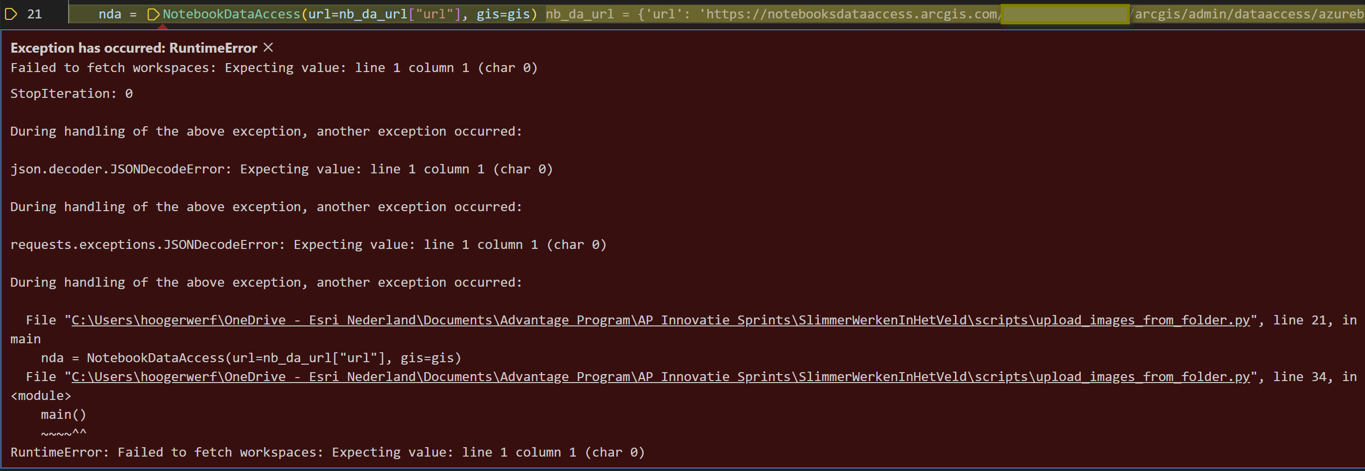

I'm trying to accomplish the same thing with the snippet you provided, but unsuccessfully
from arcgis.gis import GIS
from arcgis.gis.nb._dataaccess import NotebookDataAccess
gis = GIS("Pro")
print(f"Connected to ArcGIS Online as: {gis.users.me.username}")
nb_da_url = gis.users.me.generate_direct_access_url(store_type="notebook")
print(nb_da_url)
# Define the folder containing the images
image_folder = "C:/SlimmerWerkenInHetVeld/moffen"
nda = NotebookDataAccess(url=nb_da_url["url"], gis=gis)
I can see that I'm connected to the correct AGOL with the correct user
Connected to ArcGIS Online as: hoogerwerf_esrinederland
{'url': 'https://notebooksdataaccess.arcgis.com/<orgid>/arcgis/admin/dataaccess/azureblob/notebooksWorkspace'}
But the nda= line fails with the attached JSON decode related error
Any idea what I'm missing?
