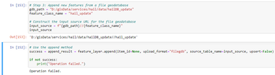

Hello,
I am trying to Append data from a feature class in a file geodatabase using API for Python.
In the past I had used ArcPy, however the process of doing so is slow and ESRI staff had suggested using API for Python instead.  I have been trying to test a few option and keep failing to do so successfully.
This is my current attempt, however I keep getting an error stating:
TypeError: append() got an unexpected keyword argument 'input_source'
I have removed my credentials and masked my domain info for obvious reasons.

If I change line 19 to use an uploaded file geodatabase within my Portal environment with this code:
success = append_result = feature_layer.append(item_id='xxxxxxxxxxxxxxxxxxxx...', upload_format="filegdb", upsert=False, source_table_name=feature_class_name)
I get an error stating: Operation Failed

Hi George,
Have you tried this?:
input_source = f"{gdb_path}//{feature_class_name}" # Note the double slash
append_result = feature_layer.append(item_id=None, upload_format="filegdb", source_table_name=input_source, upsert=False)
Let me know what happens.
Brian
ghaskett_aaic
I have tried it with '/' and '//', both failed.
Neither Notebook nor Python give me a decent error message.
