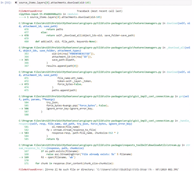

If the photo name is called "C:\\Users\\xyz\\Desktop\\xyz\\xyz.JPG' i get the error:
FileNotFoundError: [Errno 2] No such file or directory: "C:\\Users\\xyz\\Desktop\\xyz\\xyz.JPG'

I attached the error log, if it is any help.
