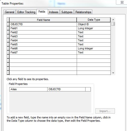

I created a script in Python to convert a txt tab-delimited table into a Geodatabase table using the ‘Table to Table’ tool. When I run the script it creates the table, but field names and data types are not following the script parameters. Fields in the output table are generally named ‘field1’ ‘field2’ etc… and the ‘Double’ data type are converted as ‘text’.

Thanks for the image of the table.  It was key to the answer.  And, the tool acts differently outside ArcMap; it creates its own data map apparently ignoring the parameter (using version 10.2.1). *** EDIT:  By inside ArcMap, I mean running the tool from ArcToolbox.  By outside, I mean from a Python IDE with ArcMap closed, although running the results snippet in ArcMap's Python window showed similar issues. ***
So, regarding the table (a tab delimited text file):  ArcMap sees a column with a 0 (integer) in the first row and 22.32 (double) in the second as "text".  My first recommendation is to change the numbers in the first row  from this:
100     0     0     0     0     200     !!
101     10     22.32     67.58     5.12     200     !!
102     20     50.55     84.12     3.65     200     !!‍‍‍
To this (so ArcMap will see them as doubles):
100     0     0.0     0.0     0.0     200     !!
Since there is no header row with field names, ArcMap will default to "Field1", "Field2", etc. So my second suggestion is to add a tab delimited header row, such as:
IDCODE     PARAM     LON     LAT     VALUE     REF_ID     COMMENT
This will name your fields with something meaningful.

Although the map contains the target field names ("IDCODE", etc.), when the table was created, "Field1"..."Field7" were used.
I then used the version of the data table with the header (field names) and removed the field mapping, and it created the expected result.  NOTE: This was tested with ArcMap version 10.2.1.

the table properties when I run the stand-alone tool look like this:
while using the arcpy script the result look like this one:
