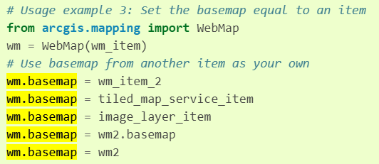

I am trying to change the basemap of a WebMap portal item using the ArcGIS API for Python (1.9.1 version). It is indicated in this link arcgis.mapping.WebMap.basemap that we should use basemap property to set new basemap using Item object.
Upon setting a portal item as basemap using basemap property of WebMap object, I'm getting this error.
Here is my code where  bm_item is an Item object. Is this an issue with the API version?
Thank you!

I have attached a notebook in the zip file.
I was able to switch the basemap of a portal webmap to a basemap from another portal web map with the notebook.  Hopefully this will help.  Let me know if you have questions.  Thanks.

Having the same issue as OP, the code snippets on arcgis.mapping module | ArcGIS API for Python doesn't work.
