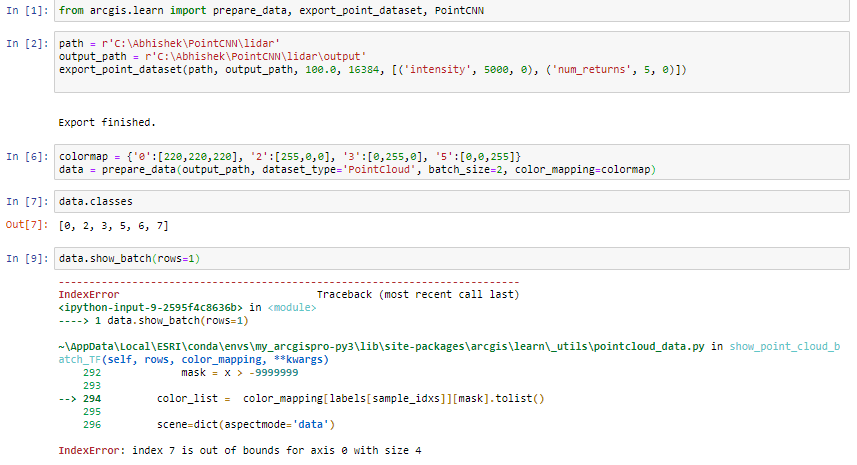

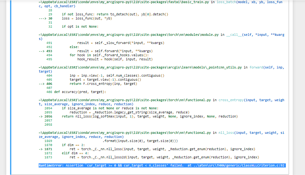

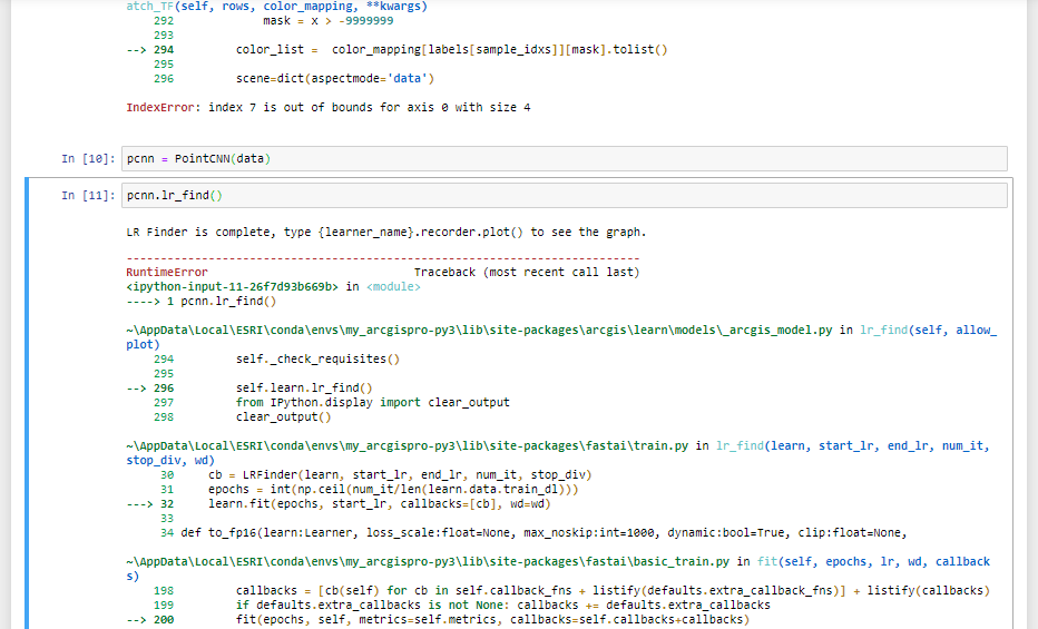

I am trying to segment lidar point cloud using PointCNN on jupyter notebook. But I am getting Index Error on running show_batch()  and runtime error on running lr_find()
IndexError: index 7 is out of bounds for axis 0 with size 4
RuntimeError: Assertion `cur_target >= 0 && cur_target < n_classes' failed.  at ..\aten\src\THNN/generic/ClassNLLCriterion.c:92

AbhishekPandey
okay so the problem is with the LiDAR classification codes. Since they are not continuous as you can see in In[7] data.classes.
how to solve it? Its simple just reclassify codes to 0,1,2,3,4.....n
