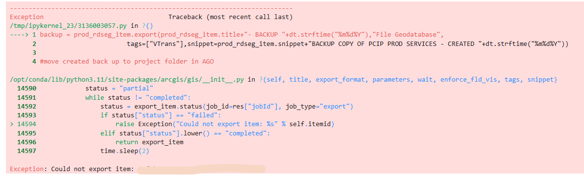

Here's the error I'm getting in my notebook:

Fix was enabling Sync capabilities on the item.
