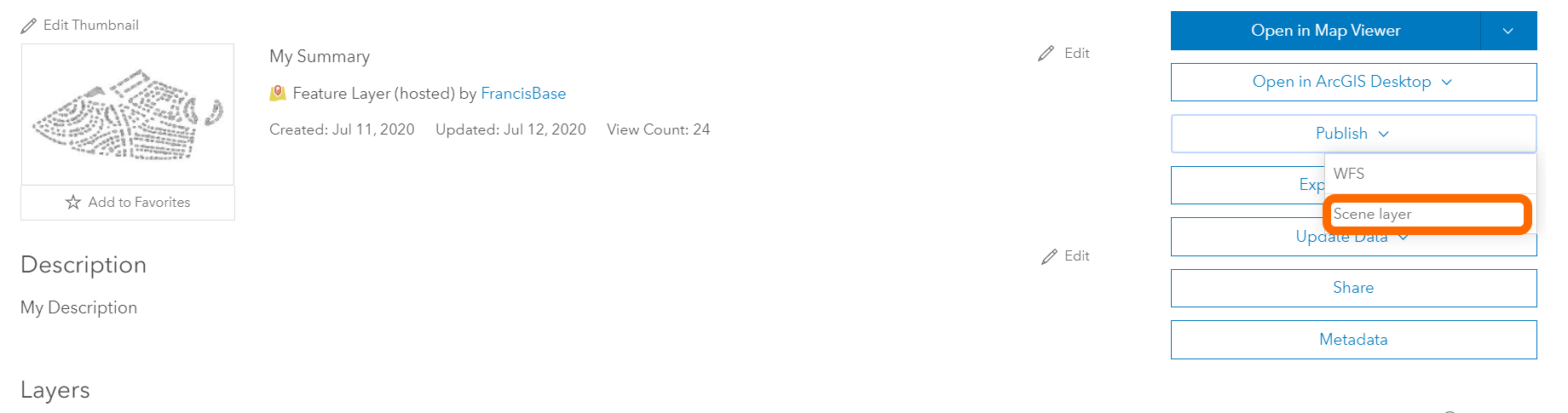

Title says it all, how can be created with code a Scene (web) Layer from associated feature (web) layer in AGOL.
It can be done manually in AGOL with the GUI.

The problem is that doing in arcpy publish of slpk you end up with a scene (web) layer only.
Which is quite different result in comparison of click the publish button to Scene layer in GUI of AGOL you get a more powerful Scene (web) layer with Associated Feature Web layer.
So i'm now sweeping through ArcGIS API for Python documentation to see if that's possible, and it looks like it is not.
Conclusion (unless further information is added by folks here): Currently is not very viable to automate the creation of scene (web) layer with associated feature (web) layer, so in the workflow going to publish the slpk to simple scene (web) layer and then try to make it work in my ArcGIS API for JavaScript application which has a lot of dynamic filters, queries and also dashboards.
