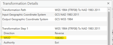

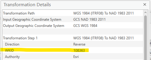

I am getting the transformation WKID from Pro, shown below.
