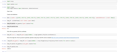

 The above code shows how I was able to get this to work.  The SEDF Polygon operator does not quite work as I thought it should.  This statement did not wori:
temp_df['new_geom'] = temp_df['coor'].apply(lambda x : arcgis.geometry.Polygon(x))
I dropped back to using arcpy geometry constructors, which seems to work.
Note this is hard coded to just work for a single part polygon with no holes.   A more general formalation would be extract the arcpy code into a separate function.
DavidAnderson_1701
I read in the pickle file, then successfully applied the method I desribed above:
test_df = pd.read_pickle(r"polyline_sample.pkl")
test_df['coor'] = test_df['SHAPE'].apply(lambda x : arcgis.geometry.Polyline.coordinates(x))
test_df['poly_geom'] = test_df['coor'].apply(lambda x : arcpy.Polygon(arcpy.Array([arcpy.Point(*coords) for coords in x[0]])))
test_df.spatial.set_geometry('poly_geom',inplace=True)
