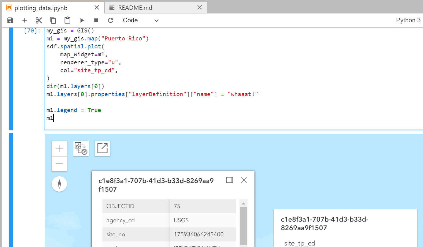

While trying to display some data, I encountered this issue where the tittle of the popups and the legend displayed are a bunch of random numbers.  I've been scouring the documentation trying to find out how to change the name displayed there but so far I've had no success.
I think the main issue is that the data that I'm passing comes from a dataframe and not from a named Layer or Feature. So either the name is generated randomly or it's some reference to some object id or something.
IE:
sdf = pd.DataFrame.spatial.from_xy(
    df = df,
    x_column = "dec_long_va",
    y_column = "dec_lat_va",
That results in the random numbers shown on the map:
Is there a way to change the title displayed there without having to export the in-memory dataframe into some other kind of feature?
