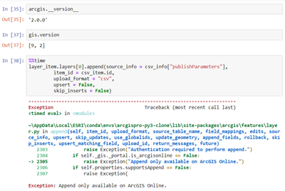

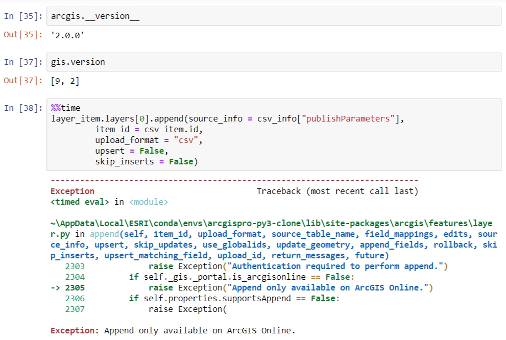

Hi,
I'm using ArcGIS Python API v2.0.0 and trying to append data to hosted feature layer in ArcGIS Enterprise v10.9.1.
It fails with a message "Append only available on ArcGIS Online".
Regarding the documentation: "The append method is only available in ArcGIS Online and ArcGIS Enterprise 10.8.1+".
Am I missing something?
Thanks,
Matej
MatejVrtich
It seems this should be resolved in 2.0.1: https://github.com/Esri/arcgis-python-api/issues/1265.
However trying to append data into ArcGIS Enterprise using the 2.0.1 version, it throws another exception:
