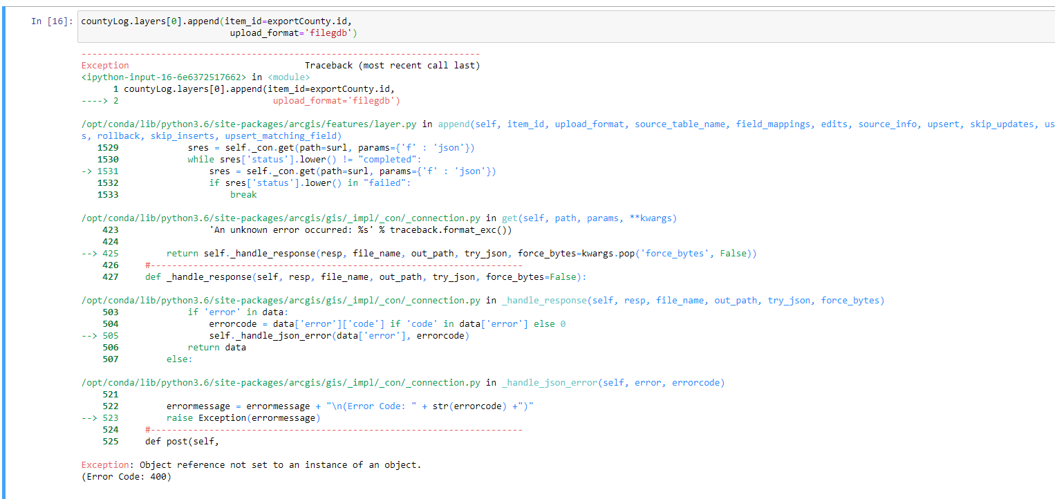

I am making a notebook that will archive data by appending data into an existing feature layer. I have the data download as a geodatabase on ArcGIS Online and then append in. It has worked for me in the past, but today it's giving me a real hard time. Odd part is, It will run if there is no data in the existing target feature layer, but if there is data in the feature layer, then I get the "Object reference not set to an instance of an object" error. Code below, any help would be great, thanks!

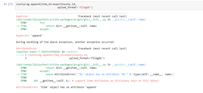

did you try
countyLog.append(item_id=exportCounty.id,upload_format='filegdb')
... sort of retired...
AFackler_NAPSG
CountyLog is the existing layer I am appending data into. I tried taking out the .layer but got an error "'Item' object has no attribute 'append'". This is in ArcGIS Online Notebooks in case that matters.

It seems CountyLog is an AGOL item rather than a FeatureLayer.
Try CountyLog.layers[0].append(...)
AFackler_NAPSG
That's what I had originally and what is giving me the "Object reference not set to an instance of an object" Error.
