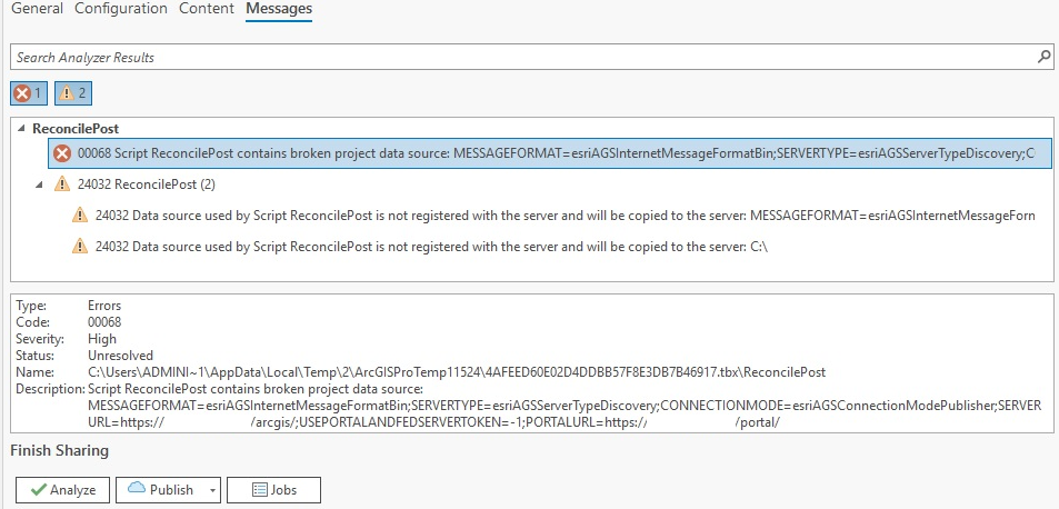

3) While trying to publish as GP Service using "Share Web Tool", getting the following errors
4) Getting the same error for the both options
