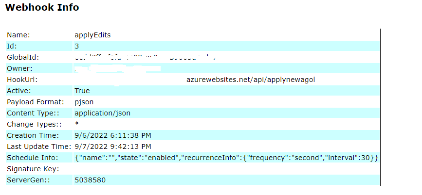

Edit - Figured I'd add this screenshot, in case anyone could see if I've screwed something up more fundamentally, here.

From your screen shot, you have Active:True and accepting any changes ("*"). So everything looks good.
