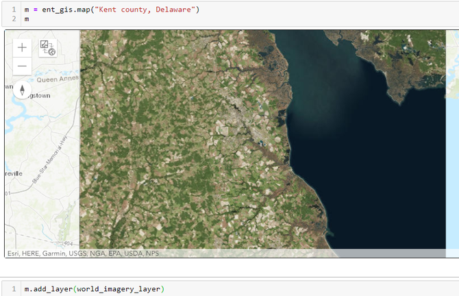

world_imagery_item = gis.content.search("title: WorldImagery_AOI_NewYork",
"Map Image Layer")[0] # the index might change
world_imagery_item
world_imagery_layer = world_imagery_item.layers[0]
m = gis.map("Kent county, Delaware")
m

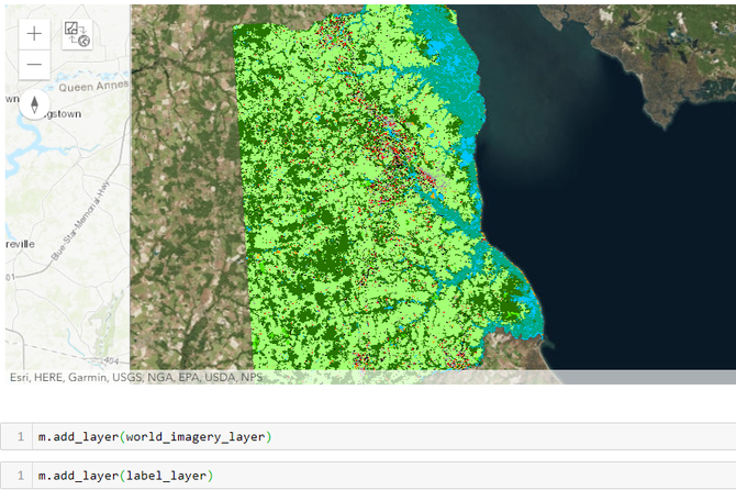

m.add_layer(world_imagery_layer)

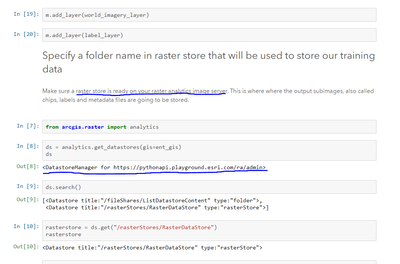

do u then know how to get an image server set up? i dont know why this isn't shown in the tutorial...
MehdiPira1
@glewi3
If you have ArcGIS Image Server installed, go to ArcGIS Server Manager > Site > Data Stores > Database
and create / register Raster Store. The path can be a shared folder.
