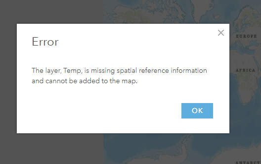

This kind of works. The item is created and appears in the GIS and I can see the data table is populated. When I try to view the item in the map viewer I get the following message however.
Clearly I'm missing something which I suspect is related to the JSON I'm adding to the item as text. I'm guessing my JSON is incomplete as I'm just adding my featurecollection.properties. I haven't been able to figure out the correct format however.

Hi @lightpro ,
It should work.
You also have the option to add spatial reference to the item properties.
item_properties = {'title': 'Temp',
                    'description':'Temp',
                    'tags': 'temp',
                    'text':feat_collect.properties,
                    'type':'Feature Collection',
                    'spatialReference':'WGS_1984_Web_Mercator'}
append_featurecollection_item = gis.content.add(item_properties)
 alternatively, you can test it on another feature layer.
