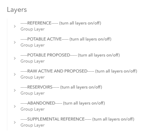

I am working in a hosted notebook in ArcGIS Online.
I am using the following code to get a list of layers on a given web map:
    wm_item = gis.content.get(item_id)
    wm = WebMap(wm_item)
    lyrs = wm.layers
I am running into an issue with web maps created in the new Map Viewer that use the grouped layer functionality. The above code reads the group layers but not the individual layers within the groups. So when run on the map in the screenshot below it returns only 7 'layers', which are actually the group layers.
Any ideas on how I can get around this?

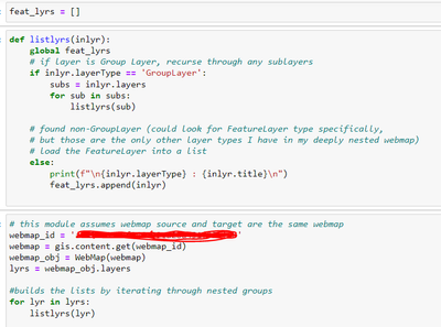

lumbrjak
I just ran up against this same issue, and took a similar approach to above, but dealt with the deeply nested layer structure of my own webmap by recursing through the layer structure to build the layer list. Seems to work for as far as I've tested (which isn't too far yet. . . )

Here is a code snippet that you can copy
feat_lyrs=[]
def listlyrs(inlyr):
global feat_lyrs
# if layer is group layer, recurse through any sublayers
if inlyr.layerType == 'GroupLayer':
subs=inlyr.layers
for sub in subs:
listlyrs(sub)
else:
print(f"\n{inlyr.layerType} : {inlyr.title}\n")
df.loc[len(df)] = [inlyr.layerType, inlyr.title]
feat_lyrs.append(inlyr)
lyrs = webmap_obj.layers
#build the lists by iterating through nested groups
for lyr in lyrs:
listlyrs(lyr)
