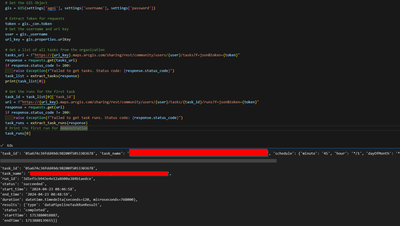

I ran into this today and figured I would answer this post since it has been awhile and no one has answered it. I don't have a perfect solution using the ArcGIS python API, however, you can view tasks and their runs in AGOL by just making a GET request. I will provide an image and a the code I used to get it below.
2024-08-21 15_42_47-scratch.ipynb - Customers - Visual Studio Code.png2024-08-21 15_42_47-scratch.ipynb - Customers - Visual Studio Code.png
 Here is the code I used if you are interested. It was hastily written so don't judge too much 😊

# Get the GIS Object
gis = GIS(settings['agol'], settings['username'], settings['password'])
# Extract Token for requests
token = gis._con.token
# Get the username and url key
user = gis._username
url_key = gis.properties.urlKey
# Get a list of all tasks from the organization
tasks_url = f"https://{url_key}.maps.arcgis.com/sharing/rest/community/users/{user}/tasks?f=json&token={token}"
response = requests.get(tasks_url)
if response.status_code != 200:
    raise Exception(f"Failed to get tasks. Status code: {response.status_code}")
task_list = extract_tasks(response)
print(task_list[0])
# Get the runs for the first task
task_id = task_list[0]['task_id']
url = f"https://{url_key}.maps.arcgis.com/sharing/rest/community/users/{user}/tasks/{task_id}/runs?f=json&token={token}"
response = requests.get(url)
    raise Exception(f"Failed to get task runs. Status code: {response.status_code}")
task_runs = extract_task_runs(response)
# Print the first run for demonstration
task_runs[0]
