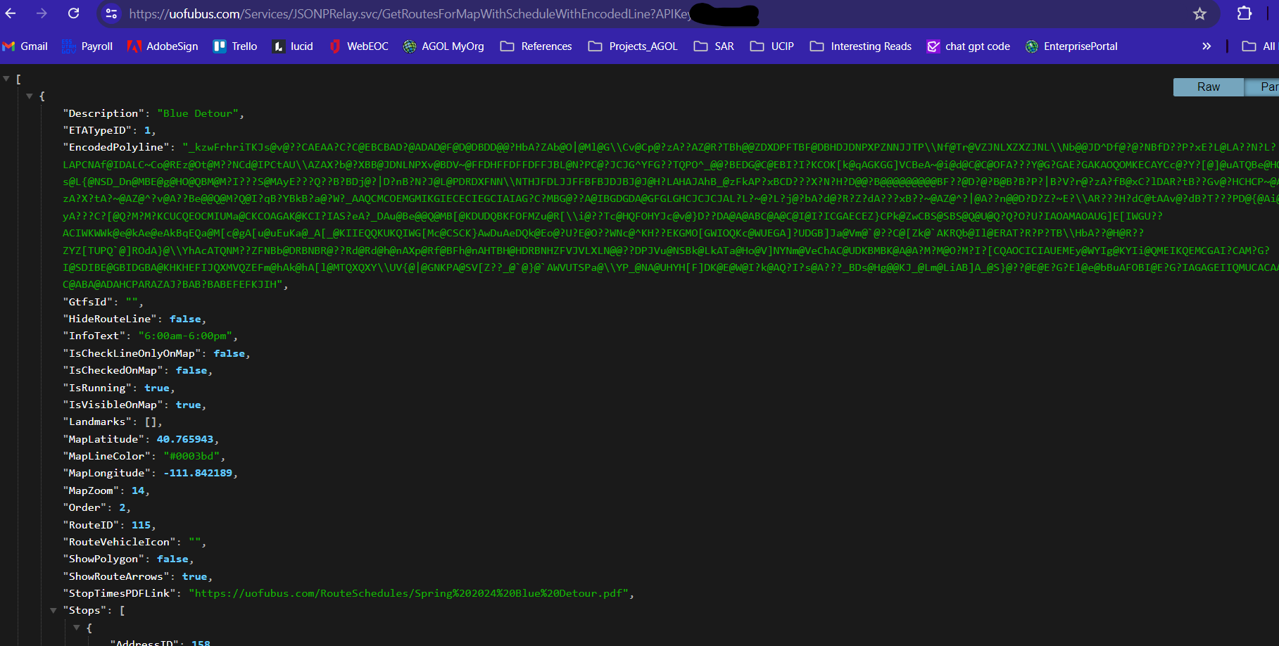

For me, just understanding the API documentation in the first place was a hurdle – but I got there with the help of various googling and particularly this blog. Once you have exactly the API URL that contains the data that you are looking for you are off to the races (pro tip: paste the URL into a browser and you should see something like this – although fingers crossed your geometry doesn’t look so atrocious). Mine looks like this:
https://uofubus.com/Services/JSONPRelay.svc/GetRoutesForMapWithScheduleWithEncodedLine?APIKey=******...
