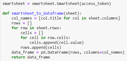

1. Smartsheet Conversion into a Data Frame
First import the modules.
Input the access token generated from the Smartsheet in the script below. After the Smartsheet authentication, a function is used to implement the Smartsheet to data frame conversion.

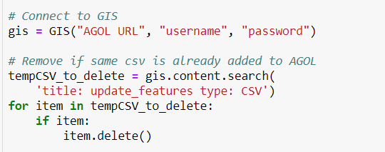

Connect to AGOL, then remove any existing csv item with the same title from AGOL.

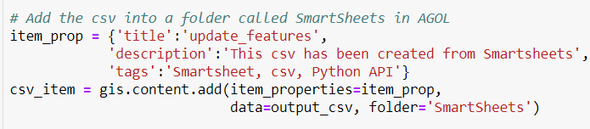

When properties are set with title, description, and tags, upload the csv file to the Smartsheet's folder in AGOL. We can skip the description and tags here and can just use the title since this item is temporary and gets deleted when a new csv is added.

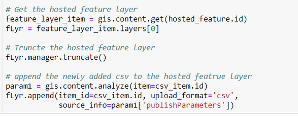

4. Truncate and Append
After that we get the hosted feature layer by id and we truncate it. This hosted feature layer becomes empty but still retains all the properties and settings.
Finally, we use the Append method to update this feature layer with the newly added csv file.
The good thing about using Append method is that the feature layer’s id does not change. This means that if the feature layer is already used in a web map or a web application, it will not break.
