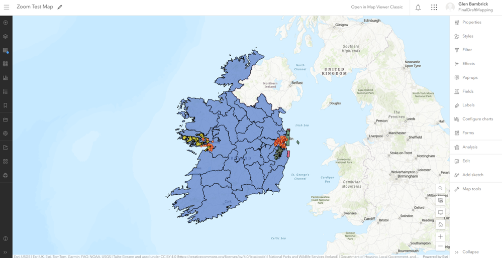

Below is a WebMap zoomed to the extent of Ireland with some layers added. The original map extent focused on Galway over on the west coast. We will use to API to update/reset the map extent using the geometry of the polygon that represents Galway.
